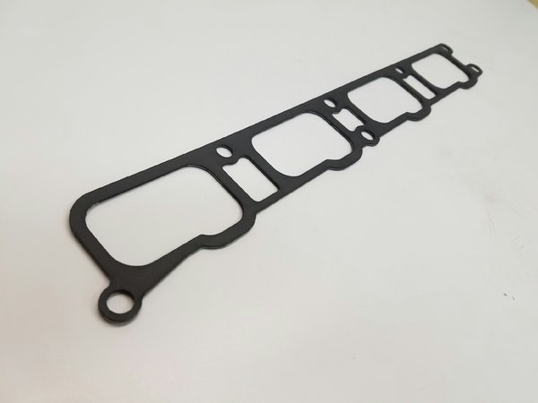

Adapted Performance have a single runner intake gasket.
https://nebula.wsimg.com/obj/MjEzM0...wZGEwN2YyZDIzOGIyNmM0NjM5OWRjNWVkNWE6Ojo6OjA=
I believe it would work out good for the CS https://corksport.com/blog/wp-content/uploads/2017/09/Mazdaspeed-Intake-Manifold-Runner-Outlet.jpg or JMF manifold http://www.therpmstore.com/resize/S...6/4__45551_zoom.jpg?bw=550&w=550&bh=550&h=550

Im running the Adapted single runner manifold gasket. I can vouch, its good stuff, and Steve is good people.

I know he is. I have purchased a few of his projects and I have a few more to get including that gasket. I was referring more to the outlining of that gasket to match up with the head and IM. I have RC PnP IM but it's not a single running. I know it it said to be limited because of the design and more even if you convert it to single runners (I can be wrong). I just want to make the right decision of porting the heads. I know it's a patience game with this.... do you have any recommended measuring tools I use to make sure everything is being ported properly and flow increased at a good balance or is that for the machine shop to test etc?
