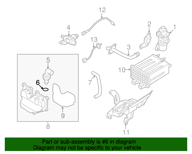

GohanX Silver Member Greenie N00B Member Greenie Member Dec 22, 2020 #3 I have a MS6, but it should be identical. Yes, there is an oring, it goes on the bottom of the PCV valve. This diagram shows the placement a bit better:
Raider Administraider Administrator Platinum Member Greenie N00B Member Greenie Member Dec 22, 2020 #4 Yes
