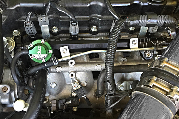

This might be fuel pulsating from the ginormous fuel pumps you guys have.
Instead of getting a Radium unit, have you guys considered looking into a Honda or Toyota fuel pulse damper?
Yes, I did think about that but was not sure how it would handle the fuel pressure in boost and how I would make it work with my current setup. Nice thing about the radium is that it is already 6an.

I can't make it out in the reroute picture, but in the first picture the pulse damper is in a poor position.
You want it parallel to fuel flow direction, not perpendicular. This will ensure max absorption of vibes. So essentially if you still kept it like the first pic, switch the pulse damper and the return line positions.
