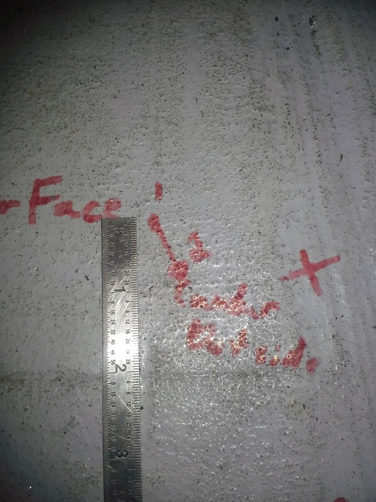

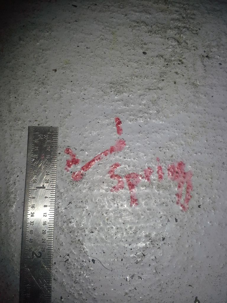

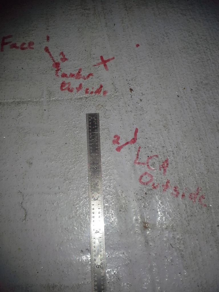

So, to capture some of this, we plot the actual change of pickup points and references points of suspension with vertical lasers like this:
Rear Suspension Findings
Preliminary Findings from Rear Suspension
These data from the test of the setup. there was not a grid setup to precisely divide X and Y by the centerline of the car, data was collected by eye and by 64th ruler.
This was collected off the rear suspension pickup points, from full droop to a point past ride height - but not full compression.
Distance between the outside lca to inside lca 17.5" -> 18.0625"
Lateral change, 0.5625"
Fore-Aft change, 0.3125" to the rear

Distance between spring sear and inside LCA pickup point 9.6875" -> 10.375"
Lateral change, 0.6875"
Fore-Aft change, 0.4375" to the rear
http://i1318.photobucket.com/albums/t646/zenit125/Mobile Uploads/20160430_114719_zpsvxeaby7u.jpg
Distance between camber arm pickup points 12.75"-> 12.625"
Lateral change, 0.125"
Fore-Aft change, 0.6875" to the rear
http://i1318.photobucket.com/albums/t646/zenit125/Mobile Uploads/20160430_114707_zpspalm0qnp.jpg
