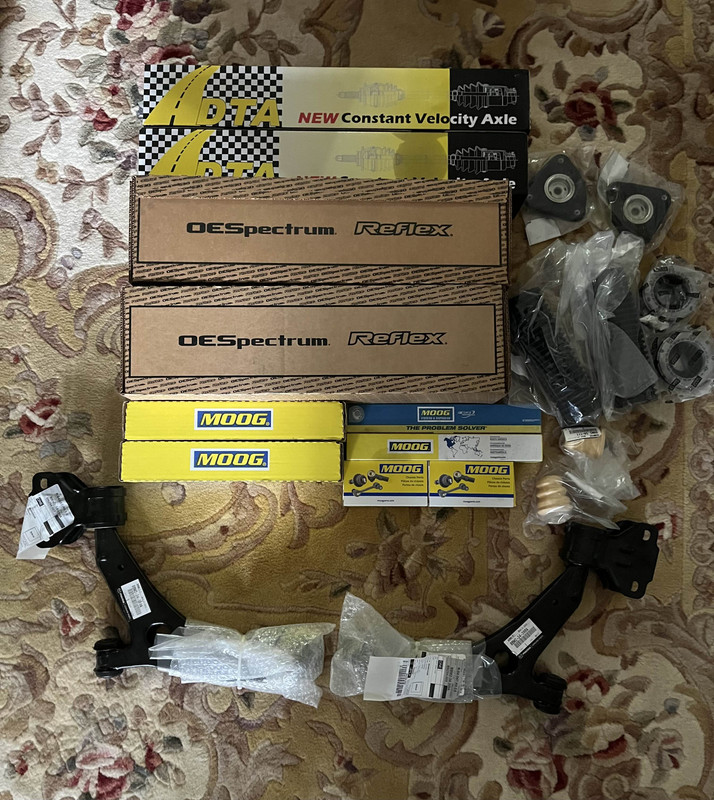

So far, the list of things that I'm going to replace are as follows:
- Front LCAs both sides (OEM Mazda)
- Front Struts both sides (Monroe from Rockauto, have had Monroes on the rear of my car for 3 years now and I like em)
- Front Bumpstops, Strut Mounts, Strut Bearings, Dust Boots both sides (OEM Mazda)
- Front Sway Bar Endlinks both sides (Moog from Rockauto)
- Front Inner and Outer Tie Rods both sides (Moog from Rockauto)
- CV Axles both sides (DTA)
- FR Fender (OEM Mazda)
- FR Fender liner (OEM Mazda)
- Right side skirt car-side tabs (OEM Mazda)
- Will need to reapply seam-sealer on the rearward inner fender seam on the front right corner because it got rubbed off by the fender liner during the accident.
The Rockauto parts are estimated to arrive next Wednesday, and I will be ordering the OEM parts from Mazda Motorsports later today. Excited to finally start repairing the car as it's been an agonizing month without it.

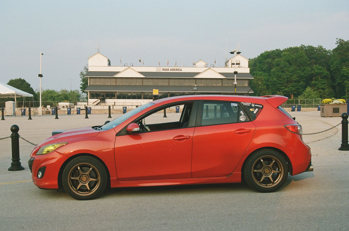

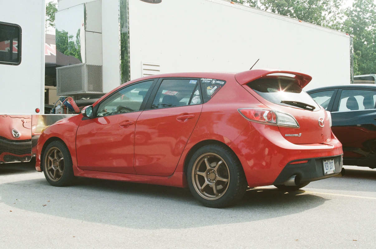

Just a few pics of the car that I took in April on my film camera to keep the vibes good before she's back on the road:
If anyone else is a film nerd, the camera is my dad's old Pentax P30t and the film is just generic Fujifilm 200
Cherrispeed3 Update:
Full-on front end refresh, just about everything suspension/steering wise short of the knuckles and steering rack is new.
Money shot:
Not pictured are the RF fender and fender liner, which I was also able to get. Total spent on parts was $1333. (Thanks Mazda Motorsports and RockAuto)

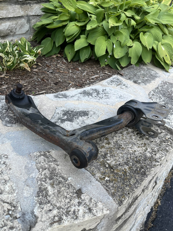

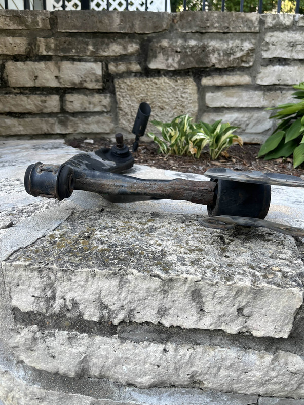

Kept the wadded up RF LCA as a little trophy:

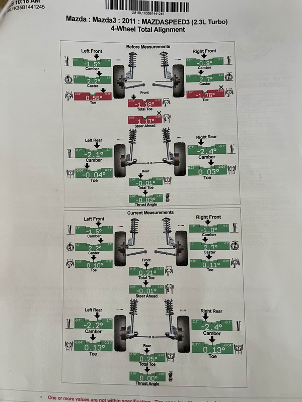

Put a fresh set of 235/45R17 Continental DWS06+ on my 17x8.5 Motegi Traklite 3.0s, and got a 4 wheel alignment.
Car tracks perfectly straight but I believe a combination of net toe out on both axles, light wheels, and low caster values within the OE alignment spec (unchanged so alignment shop probably saw it was in spec and just didn't touch it) has contributed to it having a much stronger tendency to follow ruts in the road and having a very slight inconsistency in steering weight between left and right turning between -10/+10 degrees at the steering wheel. Usually it is lighter when turning in that window in the direction that is "up" the crown of the road, so towards the left. It shifts to being lighter to the right over bumps on the right side or if road is cambered higher on right side. Was a lot more noticeable before I packed the shit out of the outer tie rod ends with grease (for some reason these moogs came unpacked, unlike my last set), but I can still feel it very slightly. There is no deadzone in the wheel and nothing feels loose/unsafe, just a minor annoyance that I think is caused by the low caster.
