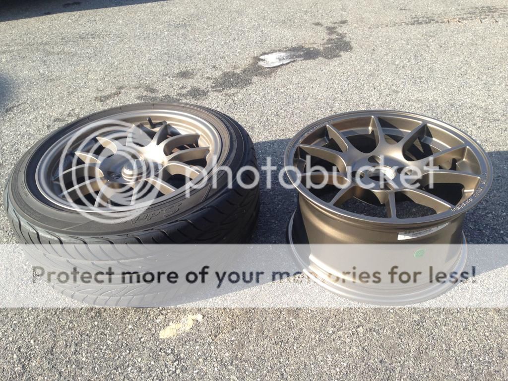

While I'm waiting for the new 15x11s to show I'm slowly getting my girlfriend's 10ae ready for autox duty this year. Here's a comparison between Gen 3 6ULs and Jongbloeds. They're a very similar color, not the crappy "authentic" bronze that 949racing uses for their Gen 4s.

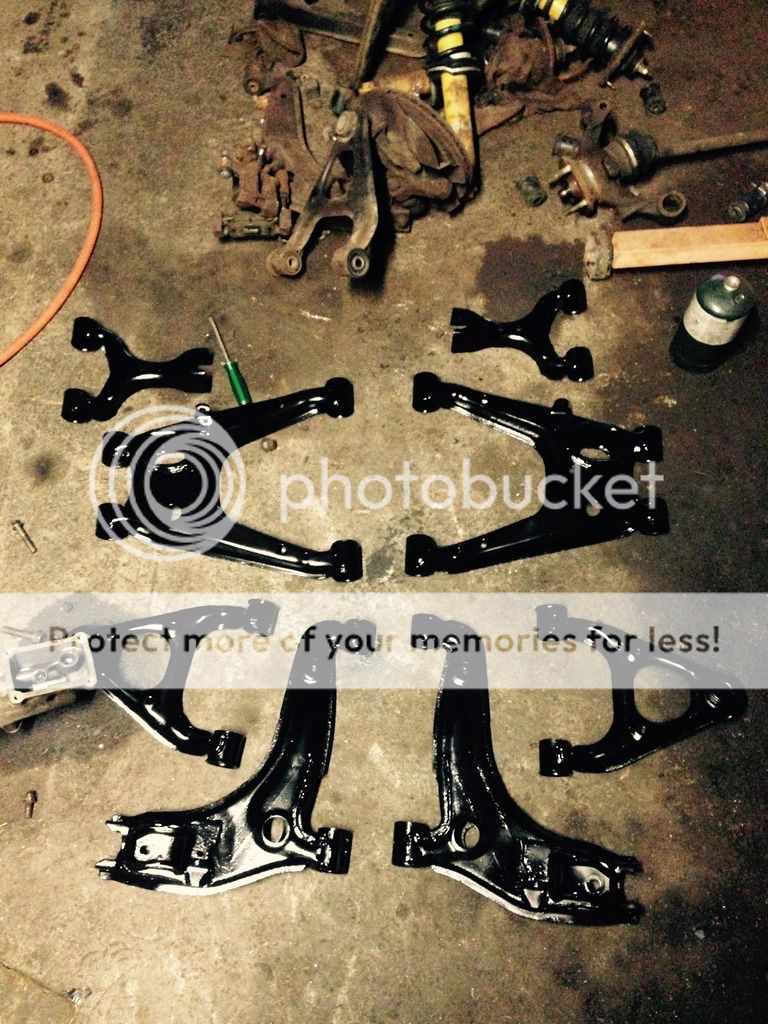

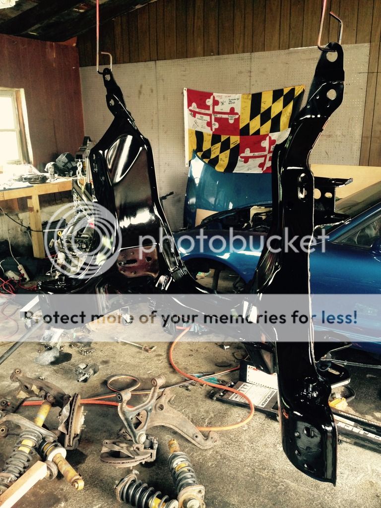

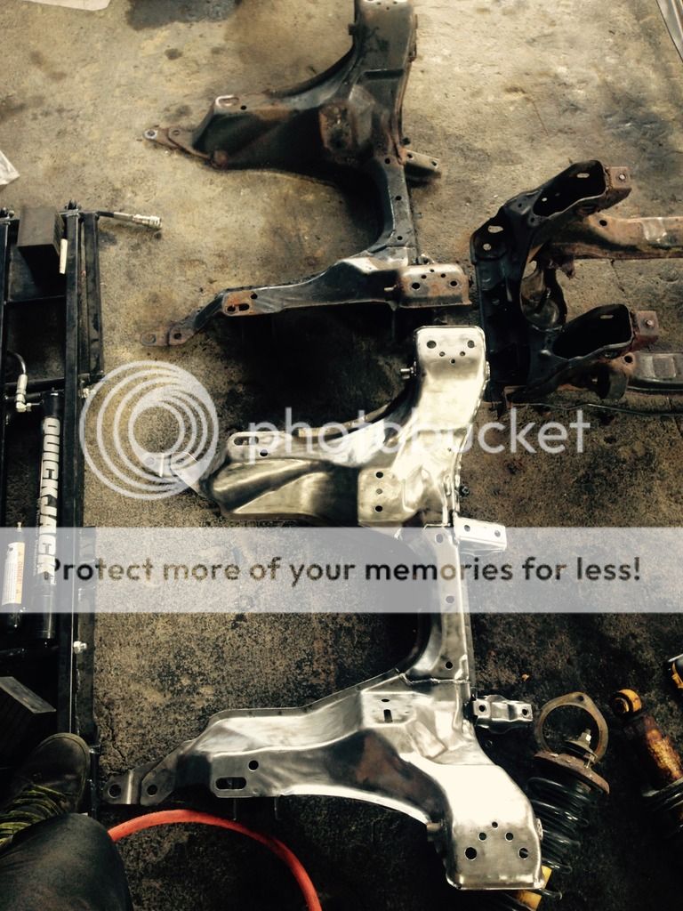

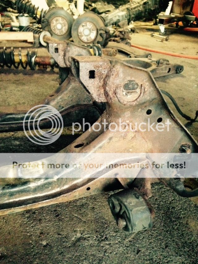

I'm also getting most of the rust fixed that was all over the suspension parts of this car. Nothing awful but a whole lot of surface rust over everything. The car is now properly undercoated and suspension is in much better shape. Its also getting the full poly bushing setup like mine. Here's some old vs new pics.

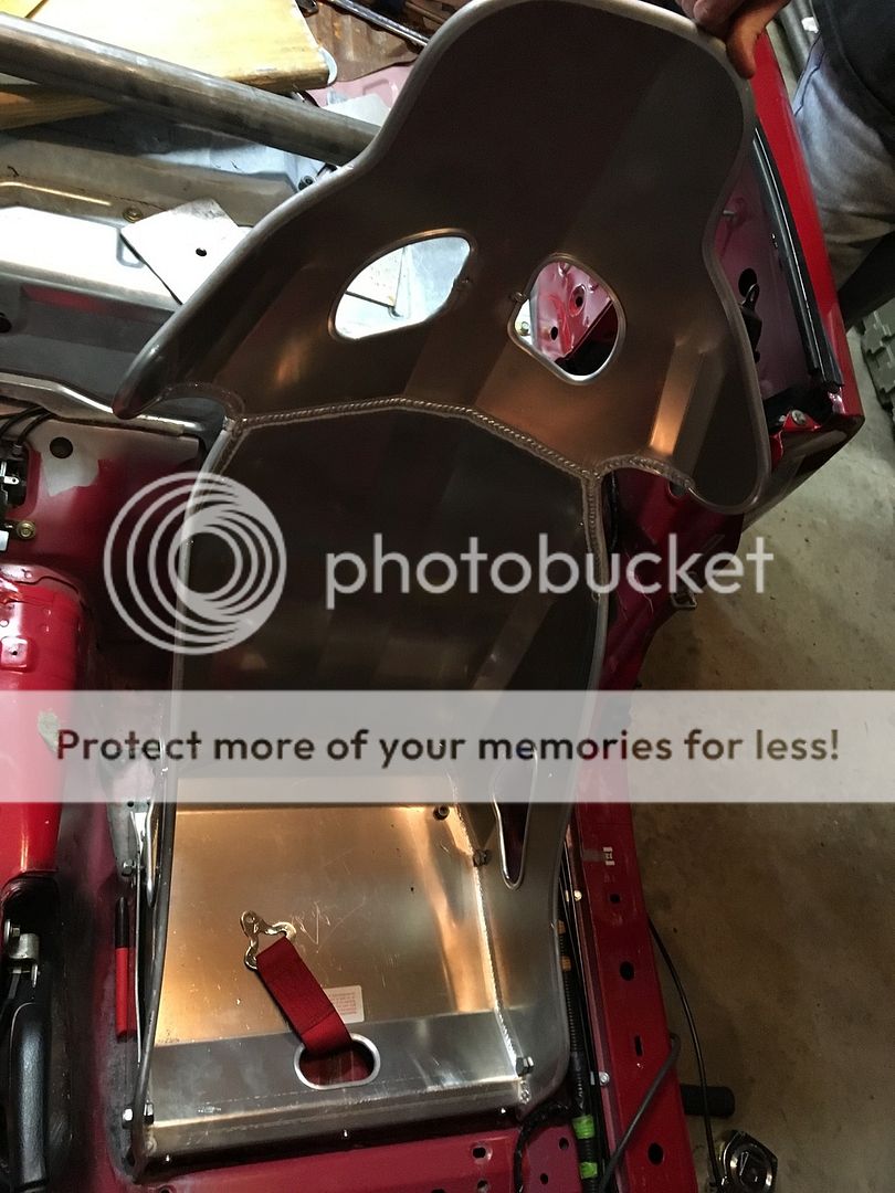

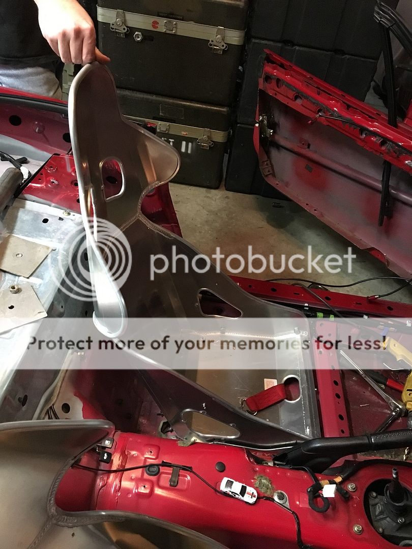

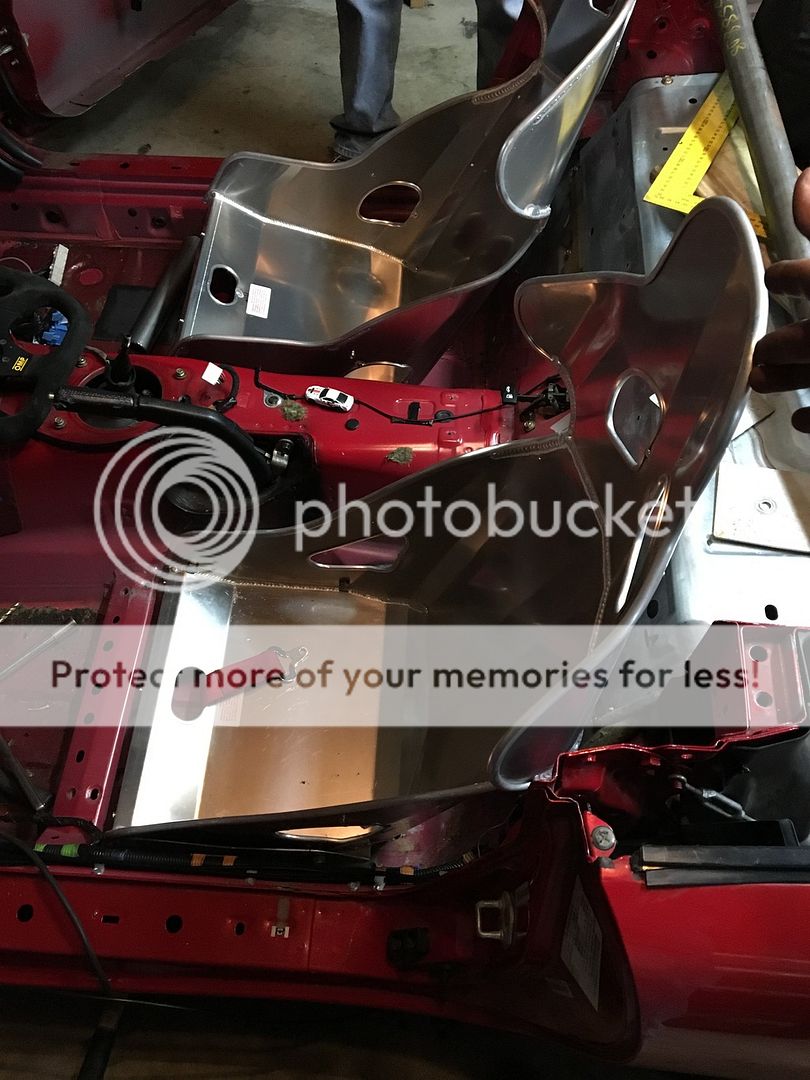

Ok well I've had a fun few days fitting seats. I had to move my 17" seat over to the passenger side since it does not allow for enough room for the door bars. I moved my 16" 20 degree seat over to the driver's side. That meant that I had move the seat up in order to clear the cross bar. So I ended up hammering flat a 2"x6" section in order to move the seat up 4". Its now against the cross bar and sitting 1/2" off the floor. I'm happy with how that turned out since it would have been impossible to get a 17" seat that low.

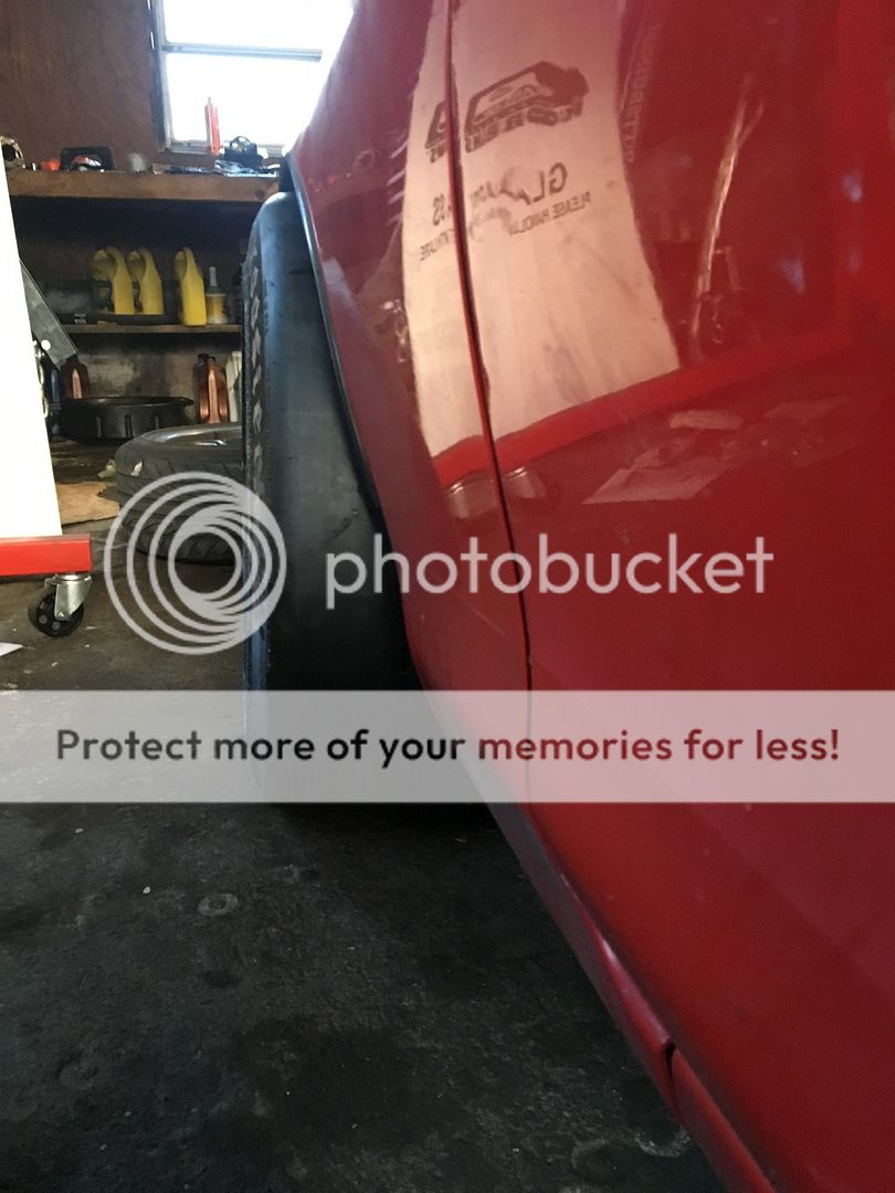

Inspired by @phate here's my 275/35/15 Hoosiers on a chop. I took about 2" off the fenders last year, may take another .5-1" off them yet. Haven't quite made it to the flare part yet. Test fit has gone well so far, just need small spacers to clear the tub in the rear.
Its door edge trim, just generic from a local auto store. That's there as protection in case the tire should contact fender, it'll at least save a hit and protect from slicing the tire (and warn me). I picked that up from a racing buddy who has used that after slicing a tire up nicely.
