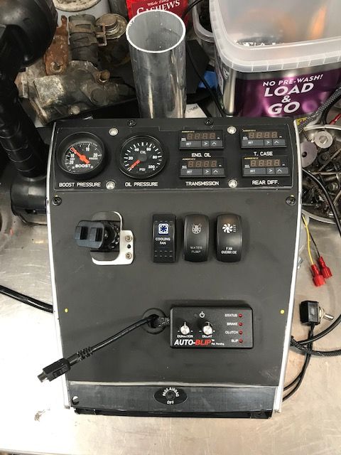

Next came putting together a center console with all the temp gauges and switches. You will also see a little device called an autoblip. This is not a mechanical blowjob machine as some of you will be inclined to believe but a throttle blippper that should compensate for my lack of heel and toe shifting. The pedal postion in the MS3 works very well for me for heel and toe but the 6, for some reason, eventhough I've modified it several times, does not. There is some youtube shit on the contraption if you want to know more. We'll see how it works.
