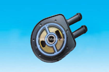

-oil cooler gasket. (the o ring where the oil cooler and oil filter housing, mazda did revise this, older version FORD made always leak)

From that list I think hpfp, oil cooler gasket and pcv plate seem most likely culprits. I've got a spin on conversion so I think I'm safe from some of those oil filter issues.

do you have the black oil cooler? Have issue at top with leak
or the raw metal one? revised and rarely leak at top
both actually works with spin oil.
if it leaks from the top then the oil goes behind the oil filter housing which then distributes it in random place,

Mind blown. I have the black one. it eas looking rough last I saw it. So that's definitely a candidate. Thanks!

If you could get a used revised (silver) oil cooler it would be great, for some unknown reason the rockauto looks like its the black one just with elbow in it, lol, the revised oil cooler have different gasket, just pure black rubber, doesnt have any blue plastic in it, like the rockauto one and the black cooler,

Ended up replacing the oil cooler, however I can say the leak wasn't coming from there.
